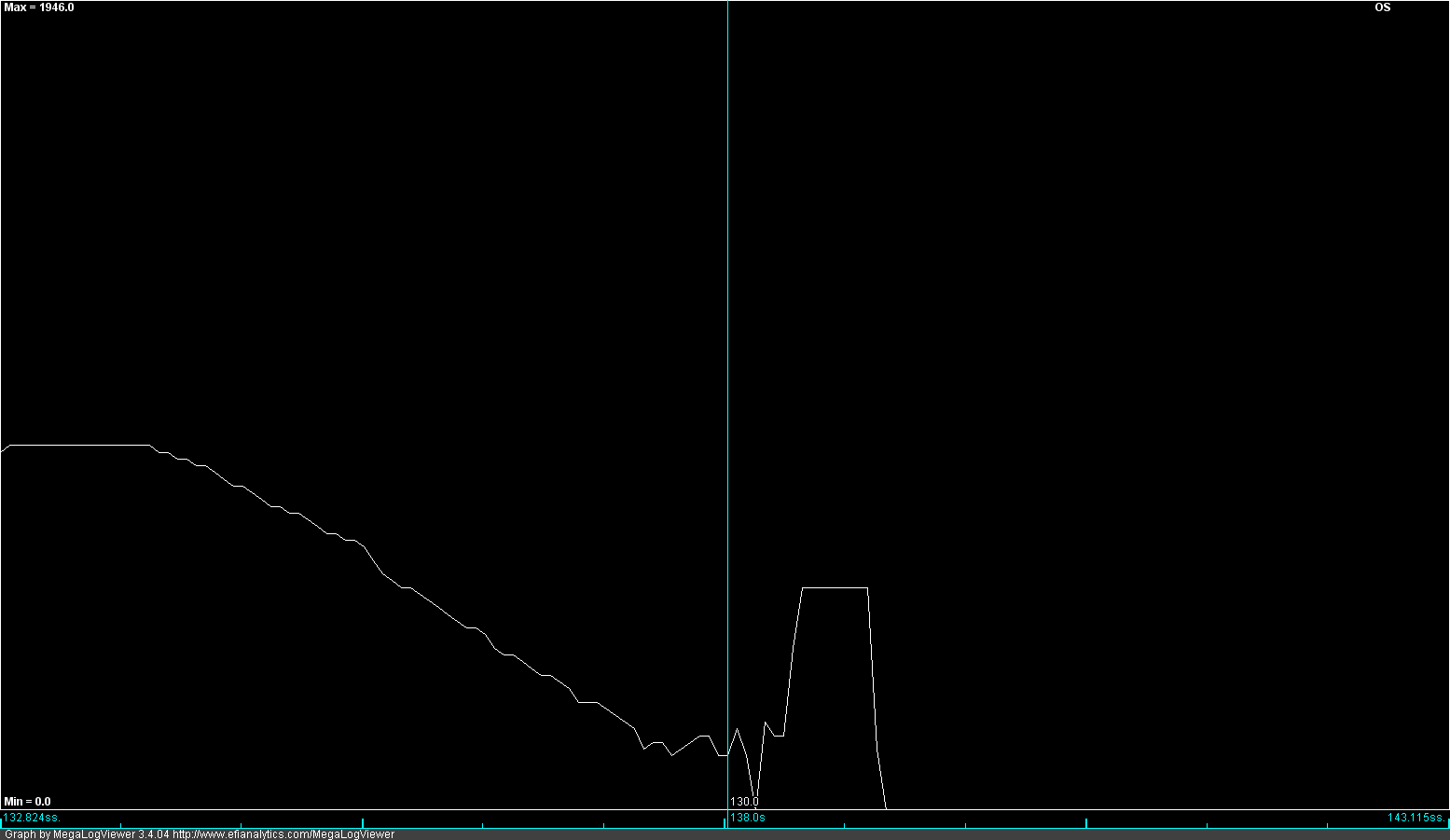

Not really when I look at your log, you have the same noice that I had as in my GPIO built for 4L80E.
This can make the code "crash" and lock up in first gear until you re-boot the ECU.
Below you see what I mean about noice in the VSS signal.
First is when you come to a stop and you get a huge jump in the VSS signal

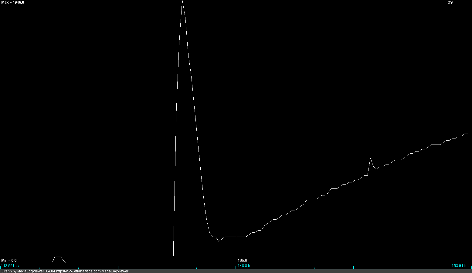

Second is when you start again and you get an even bigger jump;
I suggest that you cure that before doing anything else please read this thread on how to fix it.
viewtopic.php?f=4&t=678

Thanks for the info. I did read your particular problems with your VSS and I know my problem stems from that circuit. Attached is a log of the problem of the spiking VSS causing shifting fluctuations. Just happened to have my laptop at the time. The log is just around town driving with slow acceleration and slower speeds. If I am stopped and then release the brake the truck will move forward just a couple of inches and then the ECM goes nuts. It will shift all the way to 4th when I am just doing 2 or 3 mph then back down to 1st and then it shifts great from there. What is causing this is an immediate spike to 100 mph (max setting for speed) once the vehicle just moves just a few inches. No other problems are present and the VSS is rock solid after about 5 mph with the mask set at 80.
