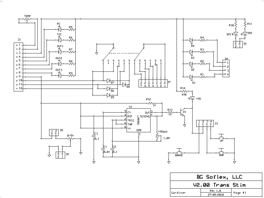

Where can I find the circuit diagrams for transstim? Mine is waaaaay too sensitive for small movements of the VSS pot. I want to desensitize it somehow by changing oscillator components.
Best regards
Philip
'80 Jaguar XJS 5.3L V12 = MS-2
'74 Jensen Interceptor Mk3 440 V8 = MS-2 + GPIO (GM 4L60e)
Re: Circuit diagrams for Transtim?
Here you go:
