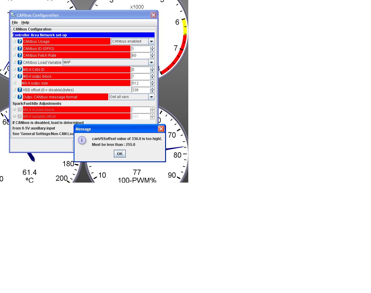

I get fever yesterday but have to try this! I load code to gpio and TS, but get still that "canVSSofset value too high" note. I try to change that "MS-II outpc size" higher but that wound´t help. Might this 255 limit be in TS?

Whoops, sorry! I just had a look at the INI, and it has a 255 limit (I must have uploaded the INI before I fixed that in my local version). The INI below *should* fix this:
GPIO_MShift_4133.ini
(217.45 KiB) Downloaded 1263 times
You need to activate it under project properties, of course.
If it doesn't fix it, let us know and we will dig deeper.
