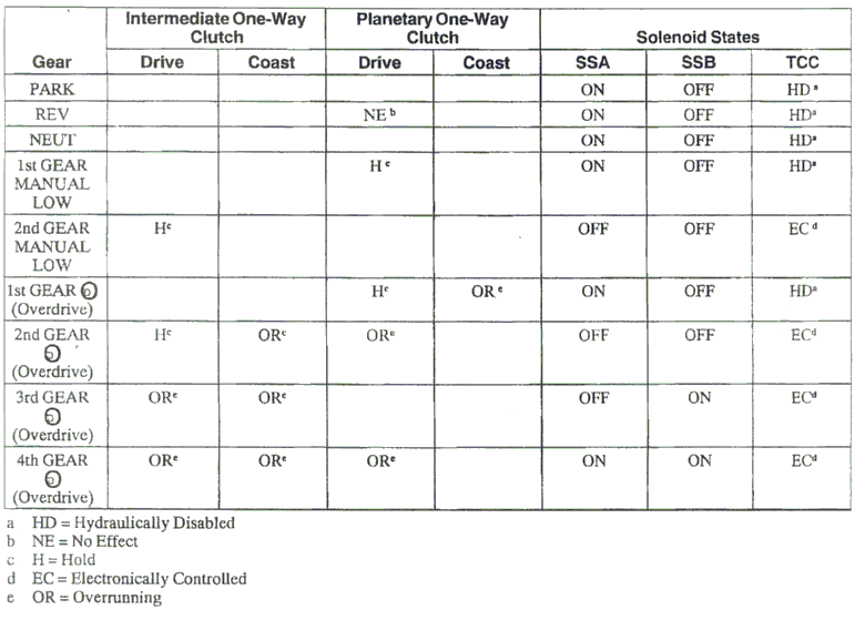

shift patterns.png (73.39 KiB) Viewed 19462 times
