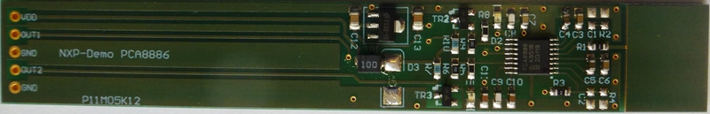

So I ran across a neat capacitive touch sensor demo board and got one shipped to me, it's by NXP, part number OM11052:
http://www.nxp.com/demoboard/OM11052.html
As near as I can tell from the specs this thing can have up to 10mm of gap to sense touch and can be wired to an external sense electrode. So naturally I thought it might be useful for paddle shifters. Maybe some of you can take a look and see what you think. The user manual is:
http://www.nxp.com/documents/user_manual/UM10711.pdf
Looks like it runs on 3-9Vdc so a limiting resistor will be needed or maybe a voltage regulator, or it could perhaps run off the 5v supply.
The board itself has no attachment points for external sense electrodes. It has a couple of pads on the board. I plan to power it up and play with it a bit. I think it outputs a 250ms pulse when it detects which I'm thinking should work pretty well for a shifting signal. That big pad on the right is the smaller of the two and the other one is a long one on the back, about half the length of the board. Maybe we could scrape off some insulation and solder a lead on there. It's small enough (about 5/8" wide) that it can be concealed inside the steering column cowling in many cases.
The advantage of course is that the shifter paddles can be hard mounted (with an insulator). No pivots or mechanical switches. That should simplify mounting a bit.
Opinions?

A little more info:
The outputs are high and get pulled low when it switches. [An LED stuck in the OUT and GND holes lights when power is on (I'm using a 9V battery) then goes out when triggered] There are trigger LED's built into the board as well which light during output (low). So it could take the place of a grounding switch possibly. I have not checked if it will sink an external source yet but based on the schematic it looks like it would (10K resistor on the 12v output source on board.) The schematic shows 12v as the source but the specs say 3-9v. It might be worth contacting them to see what the upper voltage limit really is.
The time period looks to me like more than 1/4 second, closer to 1 second. This would limit multiple downshifts. I'm not sure how hard it would be to modify that, a resistor change on the board no doubt but it is SMD. Not terribly dense though so possible. Just have to figure out which one. I'll try to hook a scope up to it later to get an accurate time pulse.
Re: Paddle shift touch sensor
This morning's testing shows it does work with gloves on. I also soldered long leads to the pads, about a foot long and touching those switches it. I clamped one lead in the small vise I'm using and the vise made a good electrode. I think this will work. I haven't heard back from them yet on the max voltage though, so for now a dropping resistor is probably a good idea.
