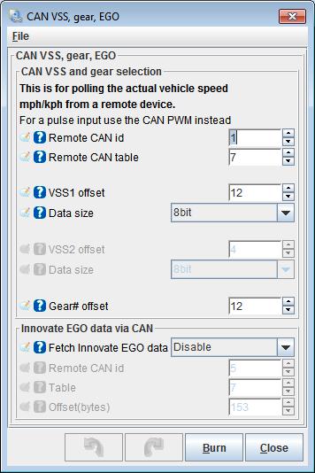

This is screen dump from MSIII under CAN-bus / Test modes.
Anyone any idea what VSS1 offset, Data Size and Gear# offset should be?

Yes, the target gear is still a positive number. It represents the gear the trans will shift to once MShift has control in the forward gears. In P, N, and R MShift is not controlling the target gear, it is just mirroring the gear lever position. So the target gear should be 1 under these conditions, because that is likely the gear you want once you shift to a controlled (i.e. forward) gear. It shouldn't really jump to -1, but it will do that if there are any gear lever errors such as the fan issue you mention (or remaining bugs in the code).

So VSS (= speedo) is 2, the gear is in 11, 12, or 13 depending on whether you want the lever position, the current gear, or the target gear (so probably 12).
If I understand this correctly, the data size you are looking for is in the Uxx or Sxx term in the third column. S08 is 8 bits (1 byte), U16 is 16 bits (2 bytes). Uxx means an unsigned value (no negative numbers), and Sxx means signed (plus and minus numbers, but the maximum is only 1/2 as much). The speedo value is U16, so 16 bits. The gear value is S08 so 8 bits (the current gear value needs to allow negative numbers to have a reverse gear, and we certainly don't need a gear range over 127 in any case!).
The table should be 7 (but 6 might work too)

Thanks for promt reply, well with data size I can only choose 8bit or 16bit from the dropdown table, Explanations says "How the data is stored on the expansion board. See documentation"
12 is probably correct for Gear# since the fan by some reason is going on/off depending of where I put the lever, not correct so will adress that at MSIII forum.

Here is how my MS3 is set.
It works right for speed and gear

Do you use MSIII to control any electrical cooling fan? I have my wired up that way using NOS1 output, it behaves very strange when I use 16bit.
If fan is running and I put it in anything but P or N it will cut the fan.......

Yes, I use MS3 to control a fan, but it nearly never goes on. I never noticed such a behaviour, but I will check next time.
