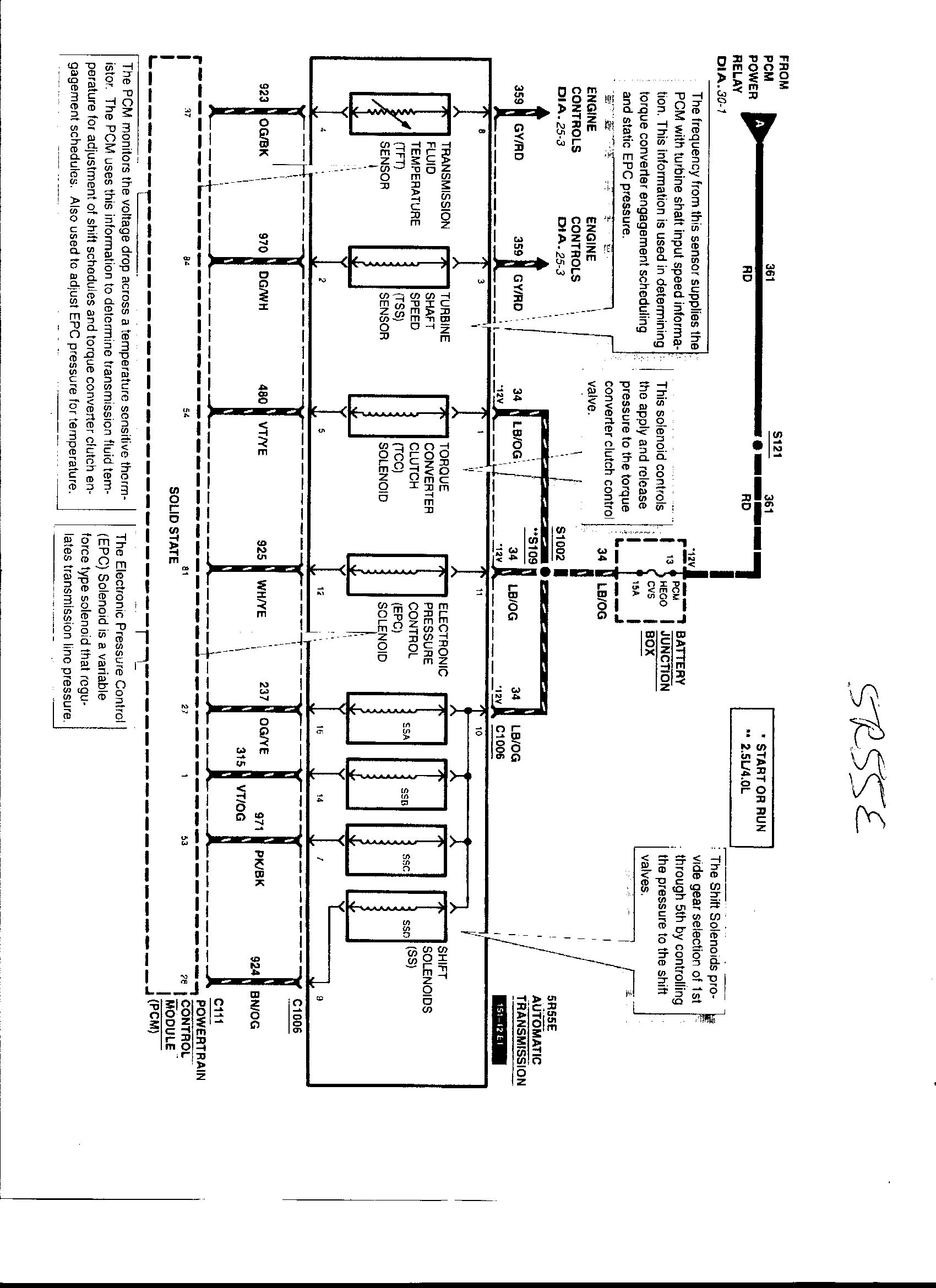

Trans connections seem very simple, I believe there is one more speed sensor for MPH
