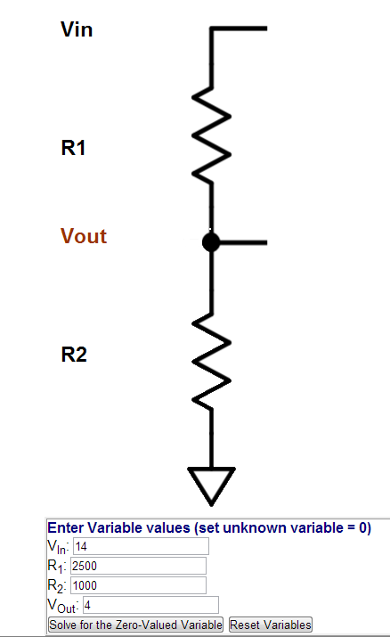

So I was doing some reading and it looks like all i need is a simple voltage divider to bring it from 13ish volts (engine running) down to less than 5. Attached is what I was planning on doing, except I'm going to throw a 5v Zener in there too.

If I'm understanding it right, this will bring the inputs for the shift selector to less than 5v. As far as Megashift is concerned the setup should be:
LEVER & SHIFT BUTTON CONFIG:
Manual Lever Mode: Digital Switches
Max Lever Position Change: 1
Digital Voltage Threshhold: 3.0 (just in case lower battery voltage it still works)
Input Patterns:
Whenever there is 12v+ supplied from the shifter on the various combonations (Park, Reverse, D, 2, L) the inputs would be HIGH for ON, correct?
Re: 12v+ on Shift Selector
shaodome,
Yes, that's the way to do it. You will need to make sure not to install any internal pull-up on the GPIO circuit (since the pull up IS the external 12V divided down).
