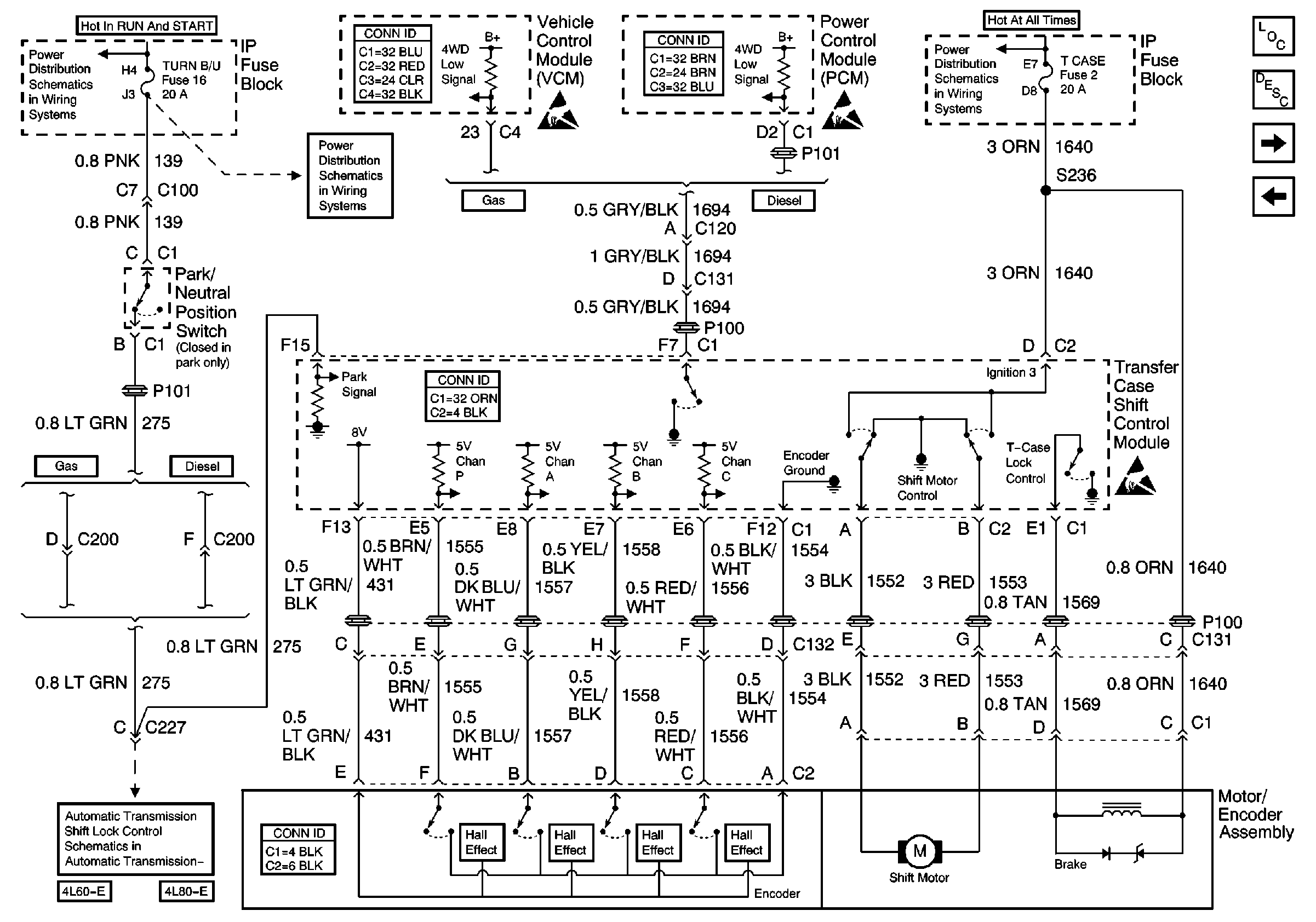

This is an example of a 2000 K1 4L60E
Joe-

Thanks, that's perfect! I will add the 2WD/4WD switch to the code (likely on PE1/GPI1/Amp5).
