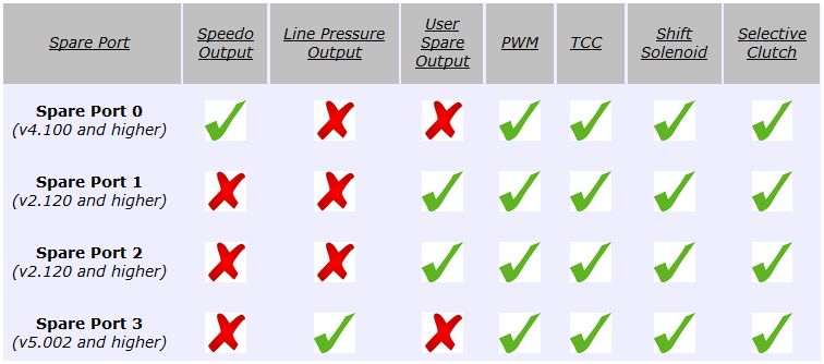

Originally, spare port 1 and 2 were implemented because these outputs had no assigned functions for the original target 4L60e, so they were made as flexible as possible for users to set when they would be on or off (i.e. "user spare ports"). More functions were added to these spare ports over time (selective clutch, TCC, and shift solenoid). Other spare ports (0, 3, and soon 4 and 5) were added because some users didn't need all of the default assignments, but they need more outputs for their application.
Spare ports 0 through 3 are described here: http://www.msgpio.com/manuals/mshift/spareport.html
The original functions are in the second and third columns (speedo output and line pressure output), the "spare port functions" are in the last 5 columns.
The web page linked by Thor_patrol also gives the original function as well as the associated spare port[0:3].

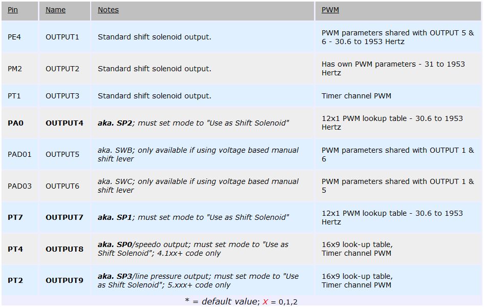

So far this is what I have, or think I do anyway, I just hope it is right:
-Output 1: PE4 through VB3, solenoid SL1 operating Clutch 1
-Output 2: PM2 through VB4, solenoid SL3 operating Clutch 3
-Output 3: PT1 through PWM4, solenoid SL4 operating Clutch 4
-Output 4: PAO through VB2, solenoid SL5 operating Brake 1
-Output 5:
-Output 6:
-Output 7: PT7 through VB1, solenoid SL2 operating Clutch 2
-Output 8: PT4 through PWM1 Speedometer drive
-Output 9: PT2 through PWM3, solenoid SLT operating Line pressure
-Output 10:
-Output 11:
Requiring to be assigned to Outputs:
- PT3 through PWM2, solenoid SLU operating Brake 2/TCC
- PT6 through EGT2, solenoid SR operating Shift Trigger
- PE1 through EGT4, solenoid SL operating TCC/Reverse on/off
In the chart, Outputs 5 and 6 are shown as shift lever position inputs, which I think we didn't do. So I still don't know what to do with PT3, PT6 and PE1, all of which are solenoids. Can I just put them on Outputs 5, 6 and 10 in any order I'd like, or is there a pattern to them?
If there is no pattern I would like to put PT6 on Output 10, then PT3 can be Output 5 and PE1 can be Output 6.

These are the assignments:

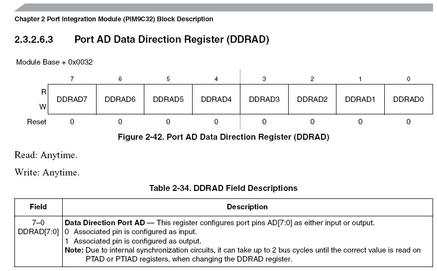

You may wonder why PAD01 (Output 5) and PAD03 (Output 6) can be used as outputs, when I said in another of your threads that, "PAD04 (line pressure sensor input) can be used as either an analog-to-digital (ATD) input or a digital input. It cannot be used as an output, unfortunately (it is not a general purpose input/output port)." I certainly wondered about that!
It turns out that the freescale docs are contradictory on this point. Some sources say that the pins can be ADC or digital input only, while others say they can be configured as outputs using the data direction register (DDRAD) - it can be used to configure the ADC pins as inputs OR outputs.
This is on page 102 of the document MC9S12C128V1.pdf
I am sure we would have tested output5 and output6 before releasing code with these enabled. However, I will re-test these to make doubly sure.
In assigning the outputs, you have to decide how the PWM works best for you. Some outputs are more flexible than others (single PWM%, 1x12 table or 16x9 table), and some share things like PWM frequencies. So you might have to juggle them around to find the best configuration for your trans.
The code output's numbers (OUTPUTx) are fixed with respect to the pin and spare port. So spare port 4 is*always* on PT6, as is output10. They cannot be moved around (though the output circuit (PWMx, etc.) can be assigned to a given processor pin with a jumper on the 25x2 header).
Processor pin PT3 is the TCC output. It is not a spare port, it has only the TCC function. So you would use it for that (added functionality can be written into the code, of course).
Processor pin PT6 is the default paddle upshift input, and has been assigned for spare port 4/output10 use in 5.202+ code versions (in which case PAD04 becomes the paddle up input).
Processor pin PE1 is the default table switching input, and has been assigned for spare port 5/output11 use in 5.202+ code versions (in which case PE0 become the table switch input).
