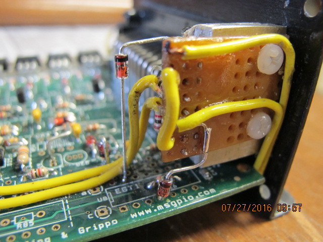

It'll be a few more days before I can check operation. Turns out I had the flyback diodes on my two off board TIP120 drivers installed backwards and had to order some more diodes. I'm going with the 1N4744 15v zeners this time. Don't know what I was thinking, must have forgotten they were zeners or something. But that had something to do with them getting hot. I was pulling 2 amps through the one on the shift trigger driver with the transmission unplugged. A bit much for a 1 watt diode, but better it than the driver. But it raises a question in my mind as to why the shift trigger driver was conducting in the first place, since I'm working from the premise that it will output a pulse when the time comes for the transmission to change gears. That being the case, it should not be conducting upon application of power with the selector in Park.

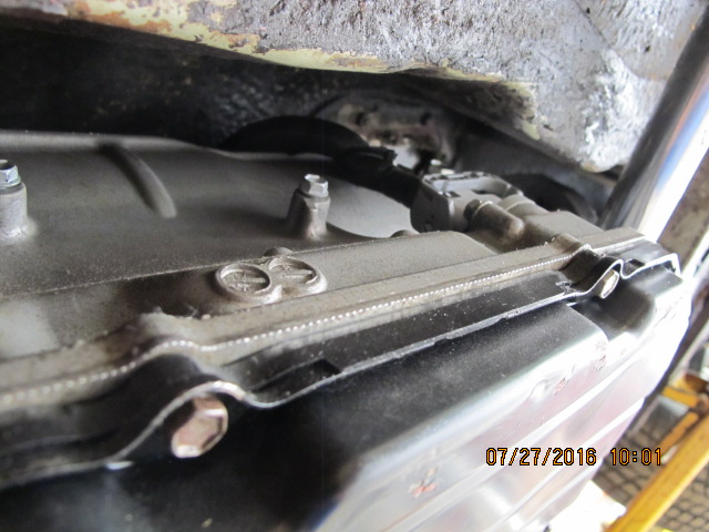

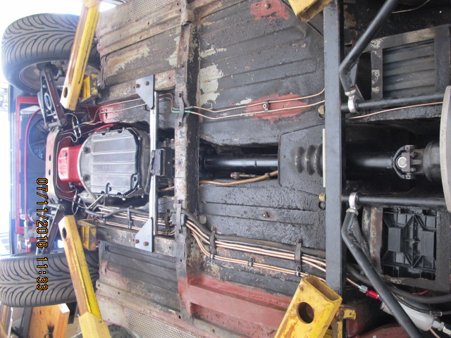

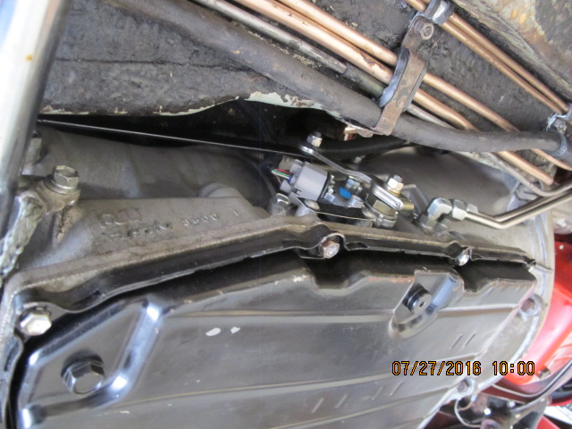

A few more photos. I considered not mentioning my mistake on the flyback diodes but if someone went by the photos on page 11 they'd be wrong. So here are some new ones. Also, some shots of the tranny in the car which show the connections on both sides, a bit of the shifter detail if you look closely. (Or not, limit 3 photos) I think you might be able to see the edge of the big rubber drive donut this tranny uses also. But the main thing is how much room there is around the transmission. Plenty of clearance everywhere you look, but not excessive anywhere. It's a big bulky transmission but packaging is quite good.
