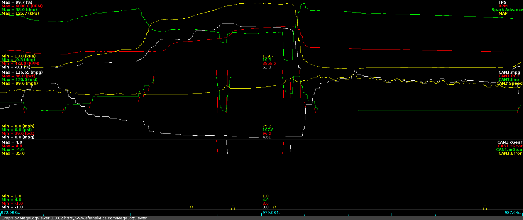

i have 2 problems im still trying to work out it almost seems like the hysteresis is not working for 3rd gear. if im at a near steady state and i get near a 3rd gear shift point it will go in and out of 3rd a few times, it happens in both 4th slowing down slightly and 2nd slowly speeding up.
The attachment 43434343.png is no longer available
second i have been changing shift completion and shift pressure delay and cannot get the shift retard and pressure adjustment to overlap the shift. looking at spark advance , line pressure and rpm show this
The attachment retard before shift.png is no longer available
graphretard again.png (43.51 KiB) Viewed 18474 times
Ashford,
As I said above, you cannot check the timing advance versus the shifts using a datalog, as the data records in datalogs are not synchronized. The only proper way to check the timing is with an oscilloscope, and the last time I checked it worked as designed. I will check again when I get a chance, though. You should also be sure to be aware of each of these settings: http://www.msgpio.com/manuals/mshift/V41tune.html#ga as they can affect the timing.

the reason i looked into the shift retard was because i could physically feel the timing retard and come back before the transmission actually shifts, changing settings seems to move how far ahead retard starts but always come bach right before the shift. if needed i can take an sd log on the ms3 at 10ms sampling rate to show spark advance and rpm.
Ashford,
Feelings aren't especially useful, we need accurate measurements (the datalog isn't an accurate measure of this timing, as I said previously) to see what is happening.
However, I suppose what you are seeing could happen if the shift is taking longer to complete than the controller thinks it should. The amount the controller waits for the shift to complete (and thus for the CAN shift timing retard to be reset) is called the 'Shift Completion Delay', and you might need to make that longer. The maximum right now is 500 milliseconds, but that can be made longer by editing the INI. Use notepad or any other text editors to find a line in the INI (near line #241) like this:
