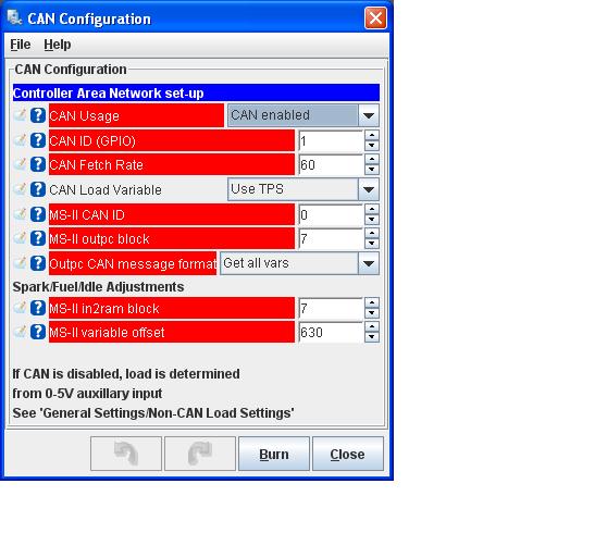

You need to do the following changes in the CAN configuration under "Tools" and change ;
MS-II in2ram block to 7
MS-II variable offset to 630
There is a question mark for the above since these values are locked in the .ini
CAN config.JPG (46.74 KiB) Viewed 17035 times

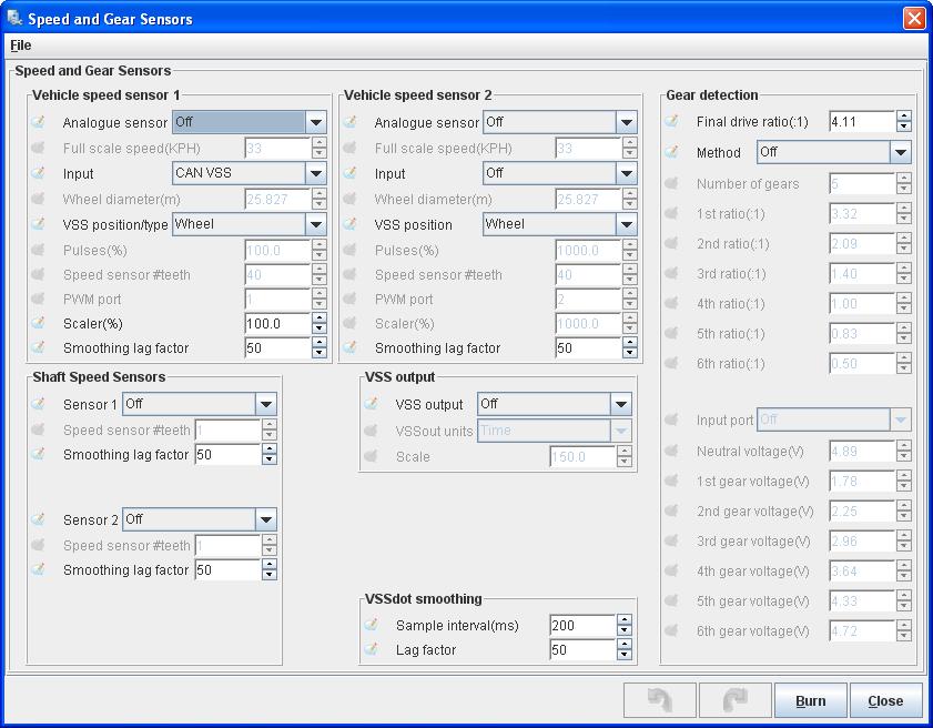

Should be On MS3 > Advanced Engine >Speed and gear sensors
Make the settings as on attached pic.
speed gear sensor.JPG (93.16 KiB) Viewed 17035 times

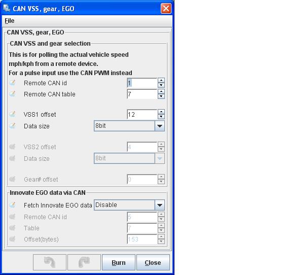

Then on MS3 go to CAN/Testing > CAN VSS, gear, EGO
CAN VSS, gear, EGO.JPG (37.81 KiB) Viewed 17035 times
