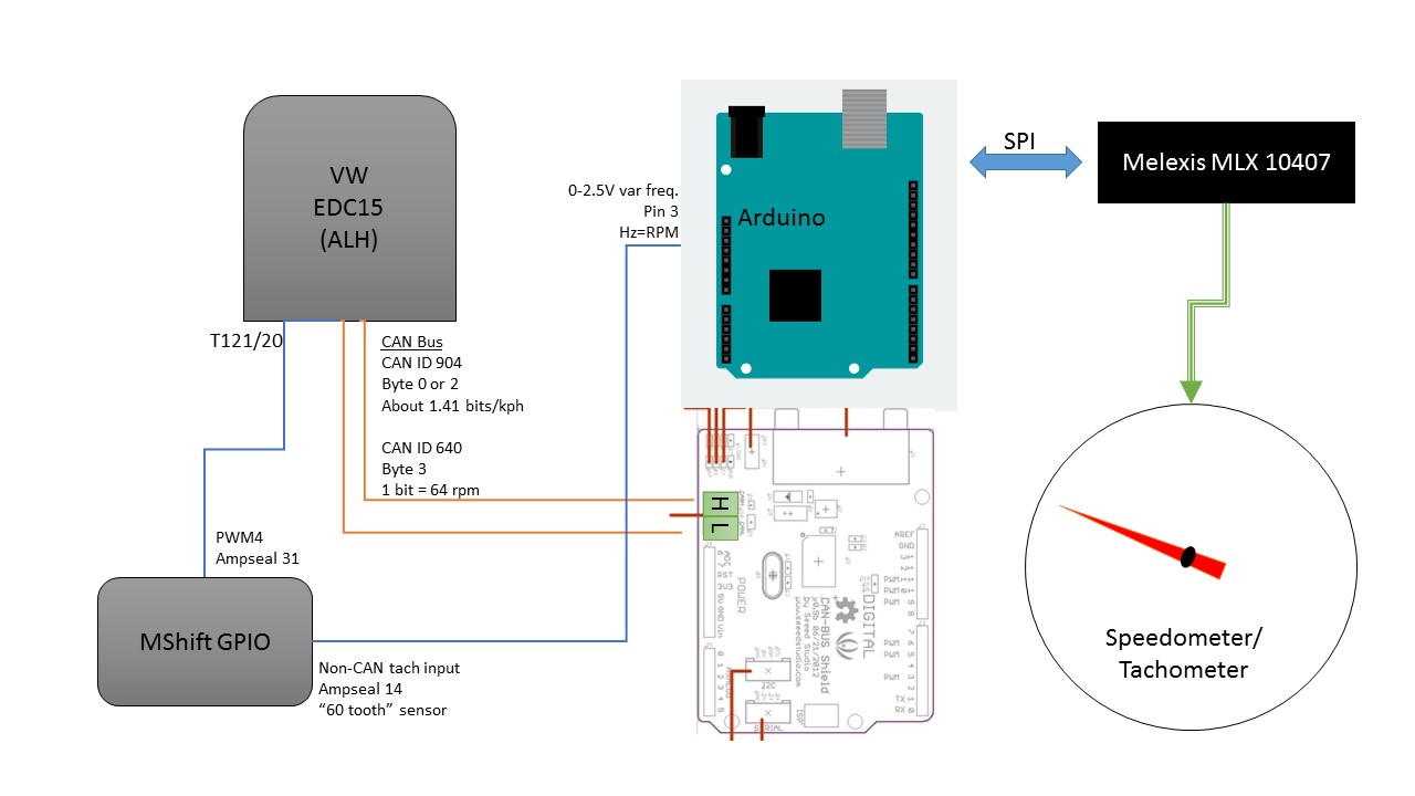

This is my arrangement for the VSS & Tach signals. A little convoluted but its mostly working.

At this point I have what feels like a driveable tune on the transmission and calibrated the pedal scaling. Thank you Lance for all the help on this!
Here's my next round of questions:
4. If I build up VR3 as in the last paragraph on this page, will that work for reading a 0-2.5V tone?
http://www.msgpio.com/manuals/vr.htm
5. Do you see any issues with the above scheme for VSS & Tach? The VW EDC15 is expecting a 0-5V signal where Hz= speed in km/hr. In the Jetta/Golf setup, the Instrument cluster would read the VSS, apply conditioning and scaling, then send to the ECM. I know the 0-5V signal works because I can do it bit banging an Arduino. I would have the Arduino read the speedo signal from the Mshift, but the ECM needs road speed to make all the OBDII features work.
6. Give above scheme, do you recommend building the PWM4 circuit per the instructions or doing anything different?
Re: Need some help with Load & tach in a diesel
Posted: Sat Dec 26, 2015 11:09 am
mcneil,
That should work. Building it as a VR circuit should work too. So you could do it either way; if it was mine I would build the digital input as it's a simpler build without the closely spaced transistor leads.
I don't see any obvious issues at first glance. However, I am not sure what sort of output frequencies you will need, and the scaling will need to be appropriate. There is more here:
http://www.msgpio.com/manuals/mshift/V5tune.html#s
and a speedo output ratio calculator here:
http://www.msgpio.com/manuals/mshift/V5tune.html#ag
The standard build should be fine for this usage.

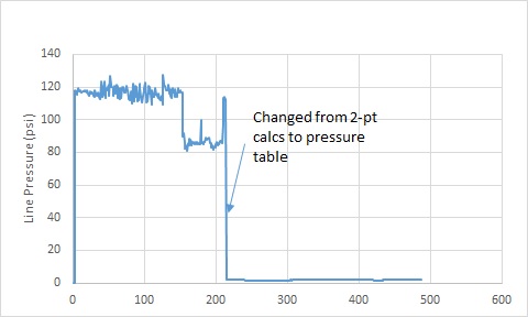

Posted: Wed Dec 30, 2015 9:34 pm
by mcneil
Lance, I think there's a conversion error somewhere in the line pressure table. I get good data on 2 point calcs, but the table is off by about 100
Posted: Thu Dec 31, 2015 10:09 am
mcneil,
Here is 5.104ti test code that multiplies the 2pt line pressure by 100 (it changes a "/10" to "*10" on one line of the 2pt calcs):
Posted: Thu Dec 31, 2015 10:48 am
mcneil,
I misread your post. I just realized that it is the regular line pressures that are 100x too small, and the 2pt calcs are okay (assuming I am now correctly following what you have said). So don't use the code posted above.
Posted: Fri Jan 01, 2016 10:52 am
mcneil,
I think the code above might work for you, but I think it will mess up people that are using metric (Bar) pressure units. So this code should work for both (I think...):
