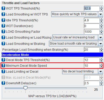

I do not see the "Min Decel Mode Speed" option, as you mentioned.
Re: WOT odd shifting behaviors
Posted: Mon Oct 19, 2015 2:34 pm
It is here in the added red box:
Funny thing is that I missed it too the first time I looked for it, I thought I forgot to add it...
