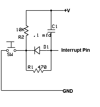

By the way I need some help clearing noise from my VSS signal. VSS sensor is a reed switch with single tooth per output shaft rotation. I have made a debounce circuit from arduino forum which help a lot in stabilizing my vss reading. But GPIO still reads 5,1 kph when the car not moving. I borrowed an osciloscope and found the signal to PT0 is jagged. Can this cause GPIO reads false speed? I need the transmision to shift to 2nd at about 5-6 kph due to low gear ratio.
Doddy

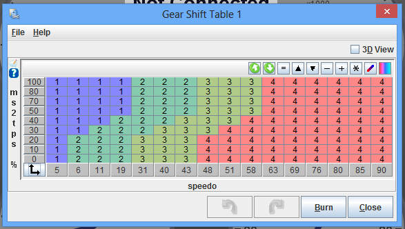

PS: I experienced late shifting too if I change the top ladder of "2nd" to "1st". It will shift around 19 kph, this is without selecting "enforce rpm check". I think this is because the pointer reads 4 square and makes an average value. Maybe if the firmware can be modified so that GPIO only reads that one square under the pointer instead of 4, the shift point can be more exact. Lance, please correct me if I'm wrong. Thanks
Shift Table.png (21.93 KiB) Viewed 166870 times
