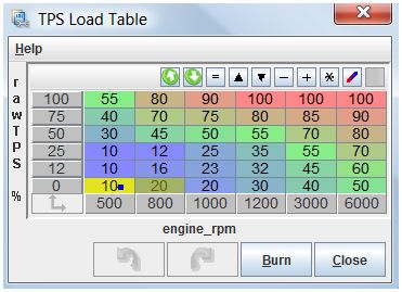

- The raw TPS value over CAN is now passed to a TPSxRPM table (6x6) to determine an adjusted TPS value that better reflects the actual engine load given the throttle opening and rpm. Generally, when rpm is low, very little throttle opening is required to achieve maximum engine output, but increasing throttle is required as engine rpm rises. The default table looks like this:
The raw TS value is the vertical axis, and the engine rpm is the horizontal axis. The adjusted TPS is the table value at the intersection of the current raw TPS and RPM. For example, with a TPS of 25%, and an rpm of 3500, the adjusted TPS would be 80%. There is more on this here: http://www.msgpio.com/manuals/mshift/V5tune.html#al

BTW, it is possible to mostly recover the previous code behavior with any of these changes (for those that might want to), by:
- setting the slider to 100% (for MAP only), or 0% (for TPS only),
- if using TPS, setting the cells in each row of the 6x6 table to the same value as the TPS bin value for that row, like this:
- putting the same shift completion delay value that was used previously in each of the eight cells of the table.
